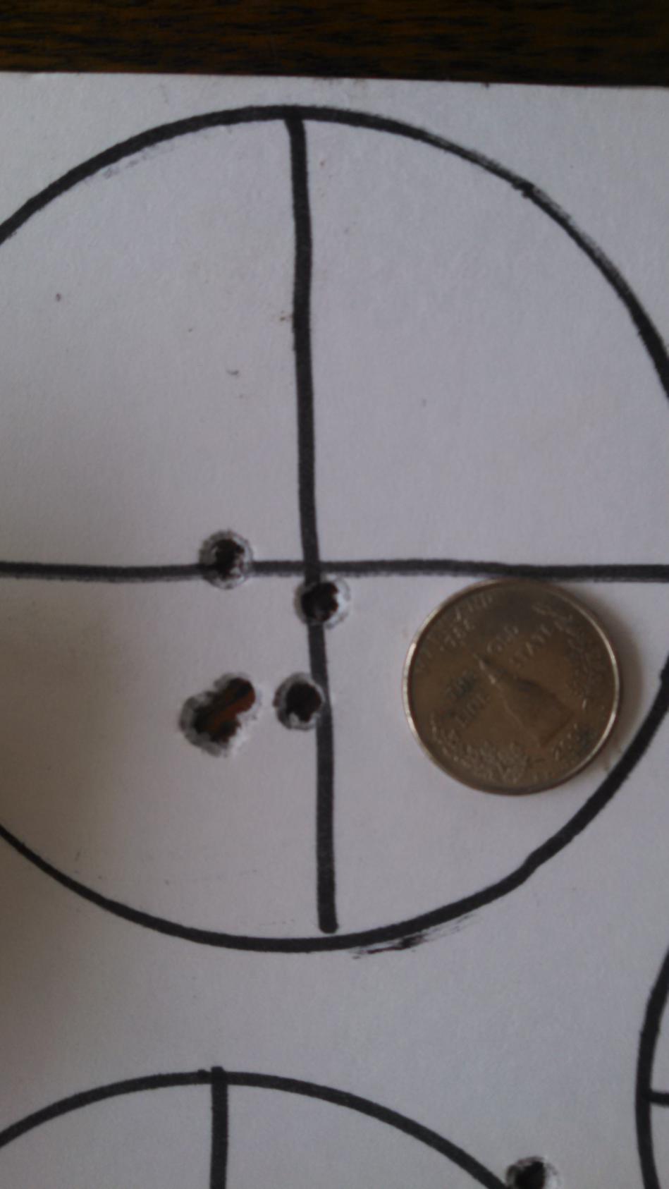

I started to do some accuracy testing. So far its pretty decent. I am getting quarter sized groups at 60yrds if I try hard and 1.5" groups if I don't try to hard.

So I went to a Dyotat valve and am now shooting Lyman mold 420 73gr I am currently running them at 930,920,910 with the 115gr dyotat hammer and valve. accuracy is decent at 50 yrds I see groups in less than a inch. at 75 yrds and running a inch or so. This gun is for hunting not target shooting. I am sure I can greatly improve the groups by adding barrel weight to the gun as it really lite. So that allows for a pretty decent amount of barrel flip. I went to the 420 mold do to the 60gr arsenal mold was not grouping well at higher speeds. I am plenty happy with the performance now. She barks and puts the smack down easy to carry and handle in the woods. Nice and lite as well. Hard pressed to find this kind of power in a compact set up as such. I am filling to 3400 psi and refilling at 2900 according to my gauges.
